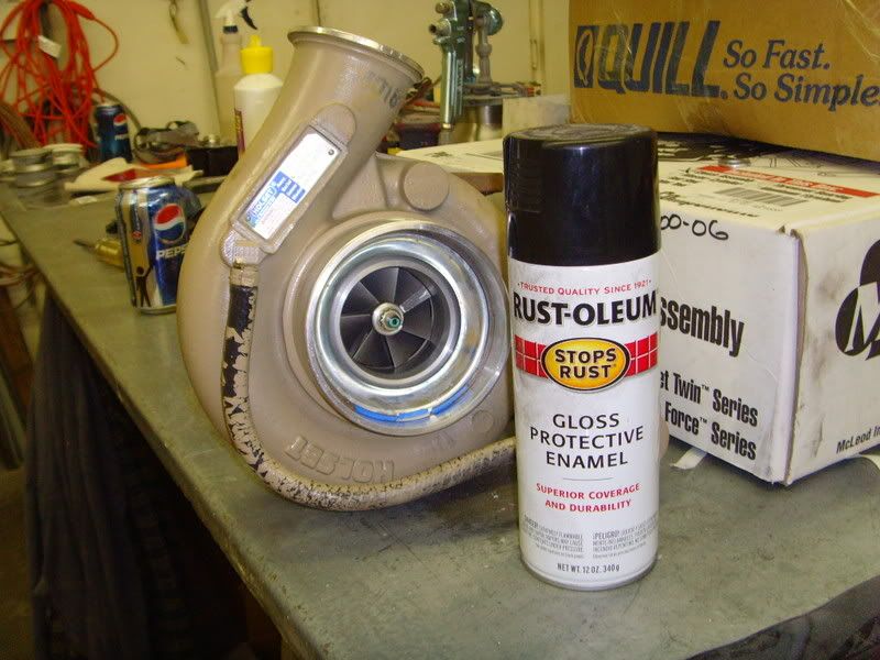

yeah, 5.9 cummins.  The hx-35 has a split scroll turbine housing while the hy-35 has a single inlet housing.  If you are going to use the internal wastegate, go for the hy, or if you want external or to use a twin scroll manifold use the hx.  On my manifold, I used a 46 mm ebay external wastegate.  Had no problems keeping the boost at 12psi(gate pressure) when i was still on stock electronics.  My turbo cost me around $325 on ebay.  Little to no shaft play and looked almost new.  Heres a pic
BTW:  Be aware that if you dont use the twin scroll manifold, It will spool pretty late(4000 or more before full spool) while my twin scroll can get full spool around 2800.

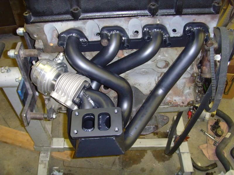

pretty much you have to build one.  I think boport will be coming out with one eventually though.  A twin scroll header is made by pairing cylinders 1 & 4 together to one side of the hotside of the turbo and 2&3 to the other.  I think the hx35 will actually fit on the factory E6, but it would probably be tight back in there.

fordguy, how did you do those beautiful tight bends?
