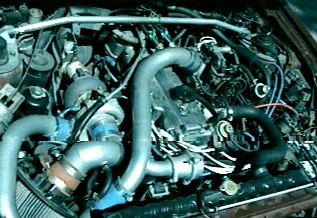

car was obtained by a fellow here non running
no one has ever heard the car run in 8 years
SOLUTION<<<<<<<< "lets bring it to scott"
car arrives in my stinking garage with a """SPARE HEAD/INTAKE/EXHAST MANIFOLD all bolted together
Symptoms
This engine is not the original according to rumor
Whomever swapped in this motor did a very fine quality job as all the wiring and dressing of harnesses ect was dont with detail in mind.  Its almost like its virgin under the hood.
I have yet to see this exact engine in any jy after looking at about 20 like it.
this engine also does not appear in the NEWYORKER, LA BARON,
the inake size is what is different.
car will crank, has spark, injectors pulse by means of the "blink test"
fuel may or may not be getting to the cylinders due to gummed up injectors but, i added fuel to each cyl and sprayed ether during cranking and still not a sign of start
compression test yielded 155/95/90/135
changed headgasket and noted piston 3 was pitted
cylinders looked glazed and heat marks at the 90deg rod angle area
changed headgasket and torqued in three stages to reach a holly shiznit number of 90 foot pounds per the local dealer specs
compression numbers are now 135/69/70/115 probably cause the headgasket isnt sealed perfectly yet, but more likely this head is .
we installed the timing belt but had to dig up the info on how that is done,,

To date we have spark, we believe the timing is correct and even if  you spray fuel into the air tube, the car does not even show a sign of starting.
we know the fuel presure is low,,(26 psi) but, to atleast get her to hit a little, adding fuel to the trottle body should have atleast yeilded a momentary start.
The TPS has about 8vdc on one wire with key on, another wire is ground and the other wire varies in voltage as i actuate the trottle body.
Injectors Blink Test,, fuel pump is operating , this tells me the computer is on line.
Injector impedance on the "spare head is 2.2ohms
Injector impedance on the injectors in the car is 2.2ohms
injector colors on the spare head is different than whats in the car
the dizzy has a hull effect system like our cars but has two magnetic pickups instead of one. The magnets are free of debris.
We have not yet perfromed a leak down test on each cylinder.,, this i need to do for sure.
Perhaps this might come down to the PWM vs return fuel line system.
timing belt install like this,,,,,,,
crank pully had to be removed to see the little dot
crank little dot pointed directly to the balance shaft little dot (2 o'clock / 8 o'clock respectively)
balance shaft had to be dialed in to drive the dzzy gear and get the rotor pointing to number 1 plug wire
Cam gear points directly up using an oval hole machined into the gear.
came gear was locked down with a piece of wedge shaped wood between the gear and the head
belt installed and it appeared that the rotor button,  crank, piston, rockers and cam all agreed for cyl one to be TDC.
any thoughts>?
my thoughts are compression related or the lack there of.  It should atleast hit a little bit.
My butt is officially kicked on this one. The car is owned by a friend of mine and im not getting paid or anything.  I only work on it when he is around so he can learn this and that as we go along.
im just stuck,, not sure which way to go other than scream "GIMMIE MY GARAGE BACK!!!!"

The original fuel delivery system in the car is internally regulated - there's a simple mechanical valve in the in-tank pump that dumps fuel as the pressure gets too high (kinda like the oil pressure relief valve in the timing cover of your 3.8). The pump should always receive 12 volts, as long as the distributor is putting out a signal.
Since the car is not even trying to start when you give it a shot of gas in the TB, the fuel pump/delivery system is likely not the issue. I'd be leaning more towards the timing. Remember, on the 2.2 the distributor is driven off the intermediate shaft. You have to align the crank, cam, AND intermediate shaft to make sure everything is playing nice together. I've attached a diagram of the timing marks for that engine to help you out.
Reading about your compression woes, I'd guess the engine has been overheated and the rings for the #2 and #3 pistons are shot (and the bores are probably warped all to hell, too).

Thanks for the diagram ,, i have the timing marks correct per your diagram.
yeah,, i had to dial in the balance shaft and i made sure th rotor was pointing to number 1 plug wire on the cap.
looks like i have a mechanical issue.

The hood sticker calles out a 2.2L turbo so that part is ok
the pics slamedcat put up took care of one issue.
it appears that the 2.2 has a slightly different valve cover than the 2.5.
On this car, it appears to be a 2.2 engine with the 2.5 intake.  That 2.5 looks like the intake setup i see here.  The valve cover is like the 2.2.
Now,, i have an extra head for the car that is junk but it has no fuel return provision and the injectors are different.
i think i shall pull the codes,,and leakdown test.
this cleared up a lot.
in a nutshell, it appears i have a 2.2L engine with the 2.5 air intake.  confussing as hell.  I still have not found that intake on the cars i mentioned but ill see about checking the other models mentioned.

shawn,,
i have spark, why would you say its the electroinc points?
also,, i said the car was an 88,,, im just not sure where you are going wtih all this.
i have the intake illustrated on the 2.5.  I think that i see a visual difference in those links with respect to the valve cover.  The far left and far right seems to have a  on the 2.5L
 that is the one and only reason i think it could be a 2.2.  since the 2.5 is the stroker kit,, how would i really know other than intakes?  ive already explained the two heads i have as well as injectors.
The "balance shaft" might be my technical jargin screw up.  What i am calling the balance shaft is the intermediate shaft that drives the distributor which is 2 o'clock form the crank per TC's file he put up for me.  Since the crank pully does not have a big round hunk of cast iron on it like our cars do, i assumed the intermediate shaft also served as the internal ballance as well,,,,,,,,,,,,TRUE?
im guessing its time to take a picture but it wont be much different than what ive explained.
