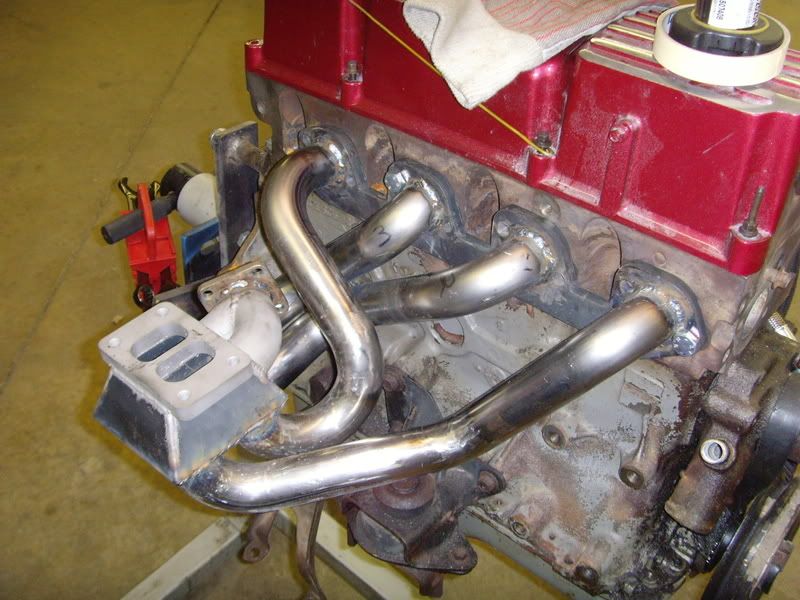

The bends were the tightest radius 1 1/2 jbends I could get from summitracing.  I had practice making the headers in my truck so it wasnt quite so bad, and didnt quite have the space restraints either.
Heres links to my photobucket album, and you can search through there for any pics you may need too.
I think this one has most of the header pics in it from beginning to end http://s26.photobucket.com/albums/c146/Fordguy545/motor%20stuff/?start=all
More pictures in here http://s26.photobucket.com/albums/c146/Fordguy545/?start=all
and a few pics of the headers for my truck.  2 1/8 primary equal length.  These took me about a month full time to make
turbo???
Headers look great.  Columbia River Mandrel Bending makes some really good and tight bends in aluminum, steel, and stainless. FYI.

Very nice.  I bet that truck sings.
