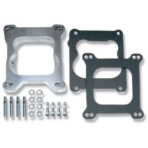

no, a qjet won't fit.. they have a small primary and very large secondary.. you need a special adapter to use 1, it's not worth it.. this is what a qjet intake looks like..
and this is the adapter you're supposed to use.. they're cheap, but the qjet is trash in my opinion

oh, and i recommend an edelbrock.. they're easy to tune and change jets/needles if need be
