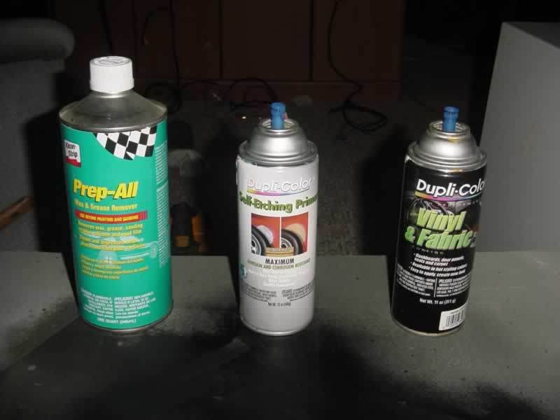

Alright Cluade, how did you prep the dash, and what brand vinyl die?
Do I have something missing too? Update 11/23
I used these three products to get the paint on.
Prep all does a  good job of cleaning the dash vinyl without damaging it like continued contact with laqeur(sp?) thinner does.
The self etching primer I was told to use by a few different sources.  It does make the paint stick better than just spraying the vinyl.
Then the paint itself is just stuff I get at autohole.  It looks nice, I get the satin like dye, as there is a gloss as well.  This looks stock and under some armor all will look absolutely fabulous.

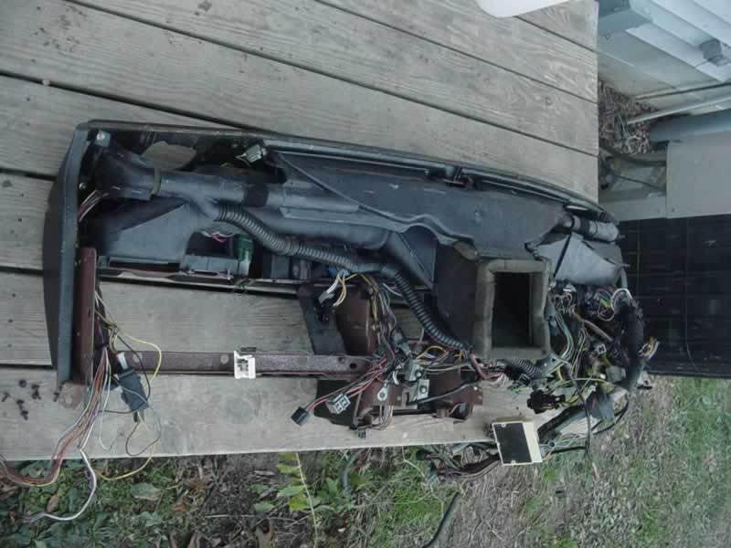

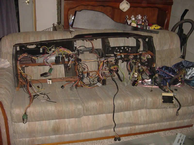

Wiring harness is in.  Its untaped because this harness was used to compare to v6/8 harnesses.

Dam Impressive!
I don't even know how to take that dash apart as much as you did, and real great work on the harness research.

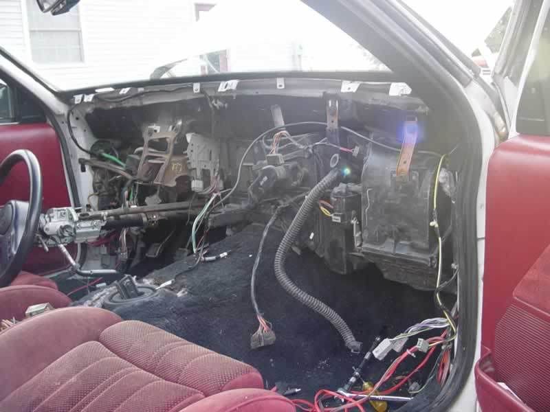

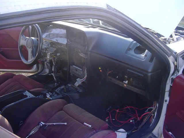

Well almost got it together today, ran out of daylight.
Here are the two heater boxes, the one I'm using is in the back.
Here is the box installed.
All of the ducting mounted back up.
And the finished product.  Its pretty much all done except for a few more connects then it can be bolted down.

Very cool man.

Sweet Dash!!! Good job on the research on harnesses.  Looking forward to the writeup on it!
You, sir, have undertaken a daunting task.  My hat goes off to you.  What a mess of wires and ducting behind that thing, huh?  Wow.

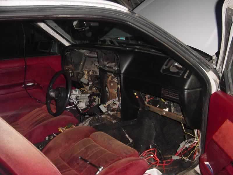

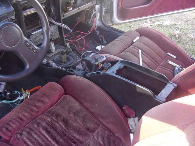

Figured it was time for an update.
The dash is bolted all the way in now, but the console is just laying there.

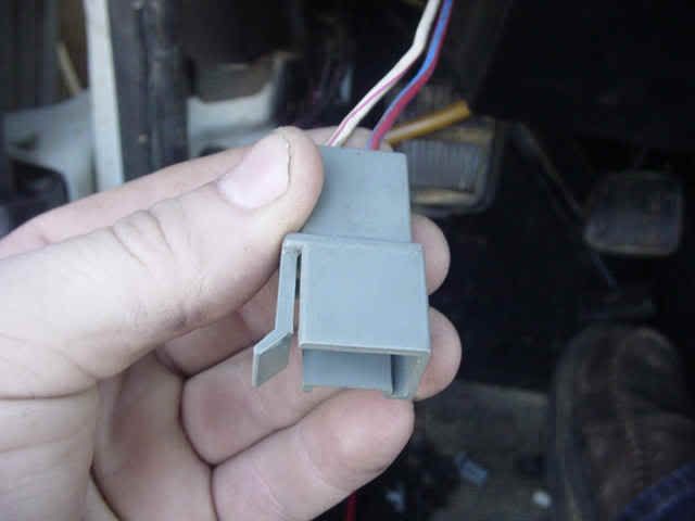

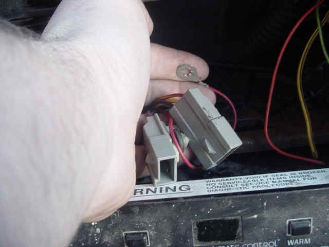

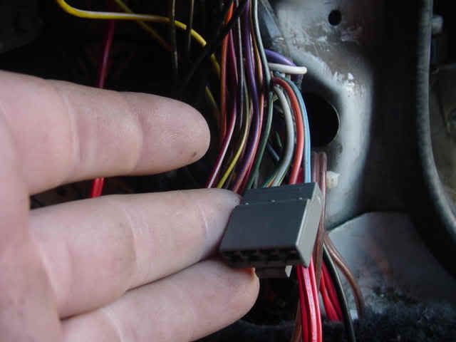

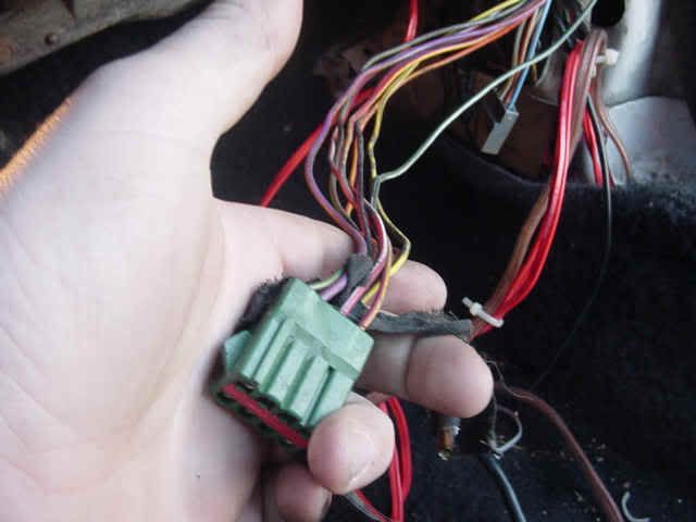

Now does anyone know off hand what these are?
I've heard tales of this one, and I think it has something to do with my fuel pump not kicking on.
This one is under the dash on the left side.  Thats not to say it should be ther.
This one is poking through the hold where the firm ride and fuel switch are.
These are behind the radio but I think they are for the firm ride and fuel as well.
Now this one...  its over by the passenger foot well where the computer is.
